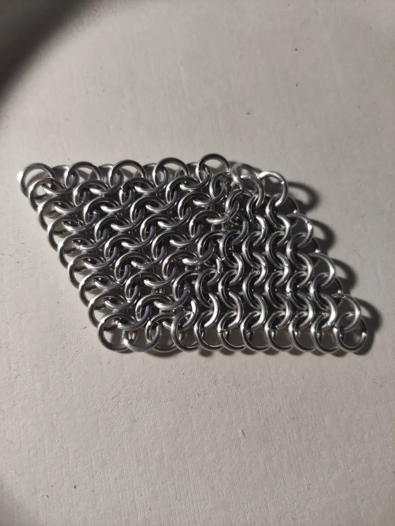

Good afternoon, I have been following the tutorial in the video to make a coif and I have gotten a little stuck. When joining my first two triangles I got the result in the attached image which does not look correct. I was wondering if I joined the triangles incorrectly or if perhaps my rings(16 SWG 1/4" ID ~ 4.0) are too small. I would appreciate any help or advice.

I'm not quite sure how to explain it, but I think this is an error in the way you joined the triangles. Let me see if I can render something. :)

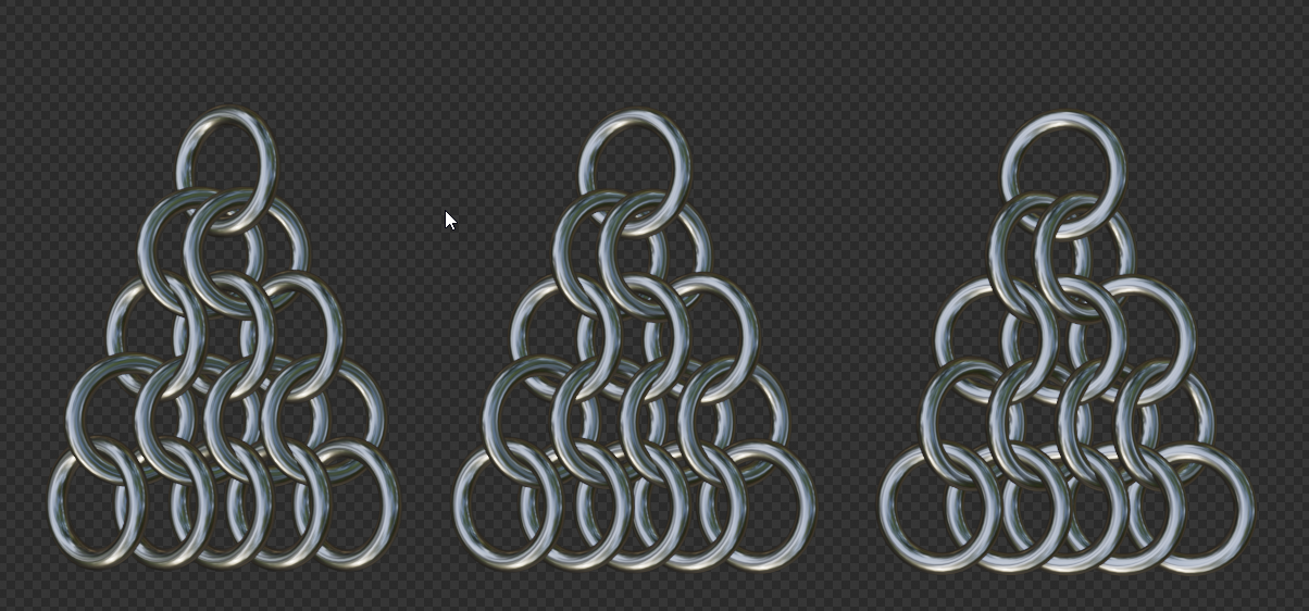

These are smaller patches, but I'm pretty sure you want them like this:

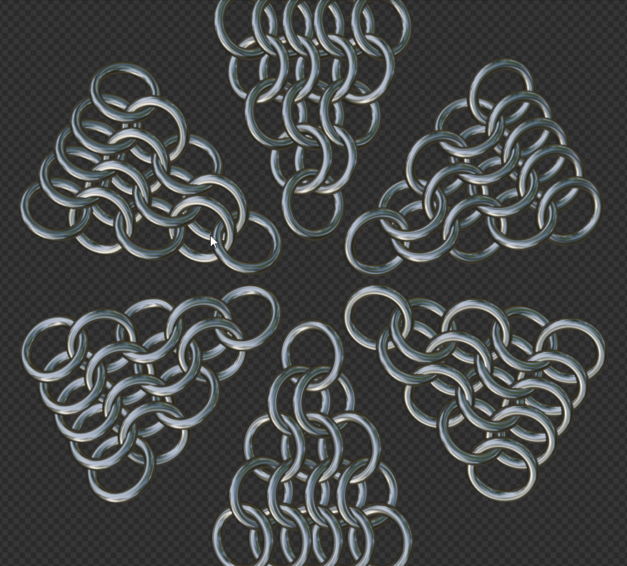

Then basically, you're just going to point them inward while retaining the same orientation:

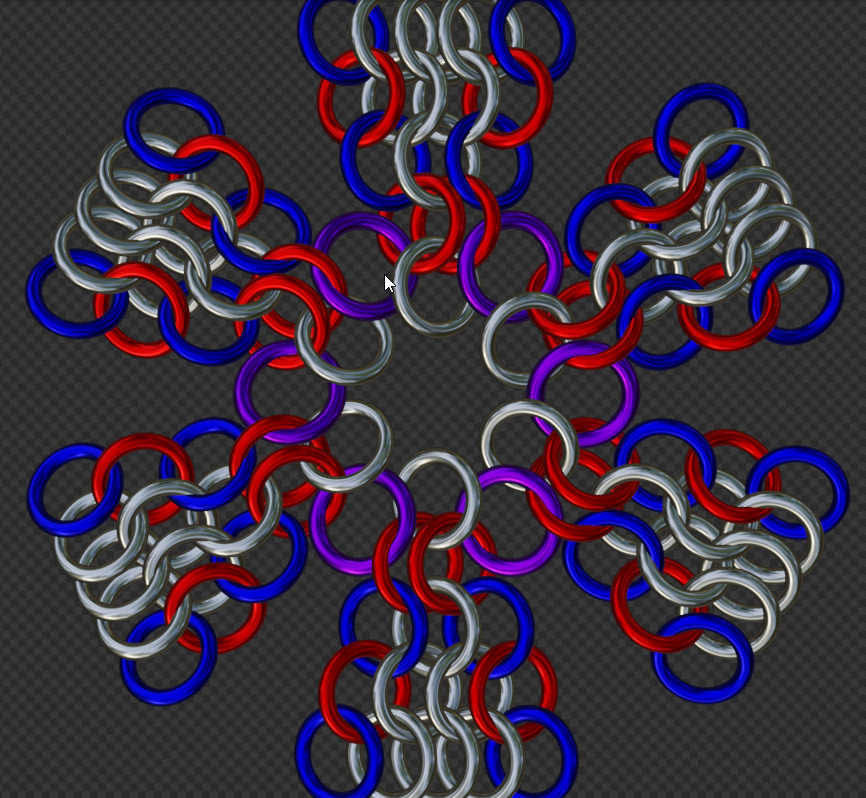

Attach the innermost red rings (from adjacent triangles):
Attach the innermost Blue rings (from adjacent triangles) AND the previous purple ring:
Repeat :)
Thank you for your input. I'm going to take what I have apart and try joining again but more carefully this time.

Just an additional note, once there's a purple ring available, you are always connecting the next purple ring to that as well, so after the first two red only, it's 2 color rings AND the previous purple.
