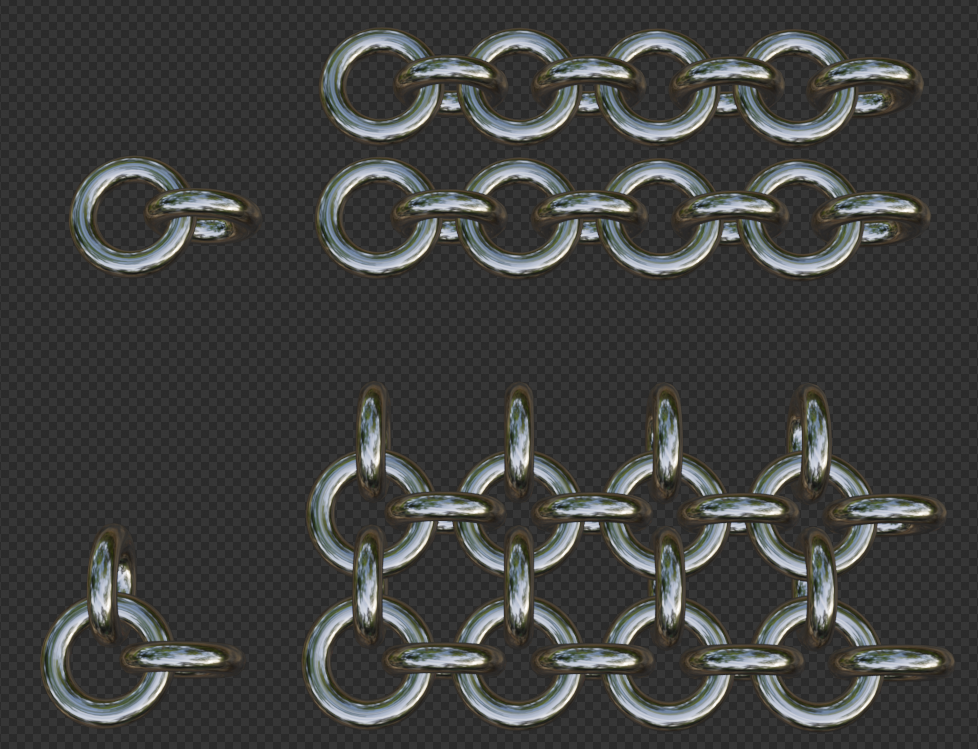

At its most basic, the definition of a cell is "a grouping of connected rings used as a single element". While root cells are simply, and always will be, 2 connected rings, there are more advanced configurations that I plan to go over in the next article. As I define a unit, many of them can be used as weave cells. Weave cells are more of a type of cell that can be defined as a grouping of root cells that can be translated to create a weave form. As there are multiple weaves and multiple weave forms, each weave can have multiple weave cells associated with it.
I am approaching this with the Euclidean geometry definition of translation (moving every point of a figure, shape or space by the same distance in a given direction). With this definition of a translation you would not be able to have units at right angles without rotations.
There you go skipping ahead again :D That is, what I consider, an advanced application of CCT (that may be discussed "officially" way down the line). It's almost all rotations in some way :) In non advanced applications, for an expansion, the weave cell may need to be modified. This is the simplest example
At the top we have 1-1 chain (2 in 1 chain) where the weave cell is a root cell. if you translate the chain perpendicular to the axis of extension (an "Expansion") (the Y axis instead of the X axis), there is no connection between the chains.
At the bottom we have a modified 1-1 chain where the weave cell is a modified root cell. When that is expanded, we eventually get Japanese 4 in 1
And yes, you can say that the modified ring is a 90 degree rotation of ring 2 of the root cell around an axis central to ring 1 :) The modified root cell, by itself, can also be manipulated to be a "terminated root cell", a "radial 2 unit" or a "segment of 2 in 1 chain" (remember what I was saying about overlap ;) )
