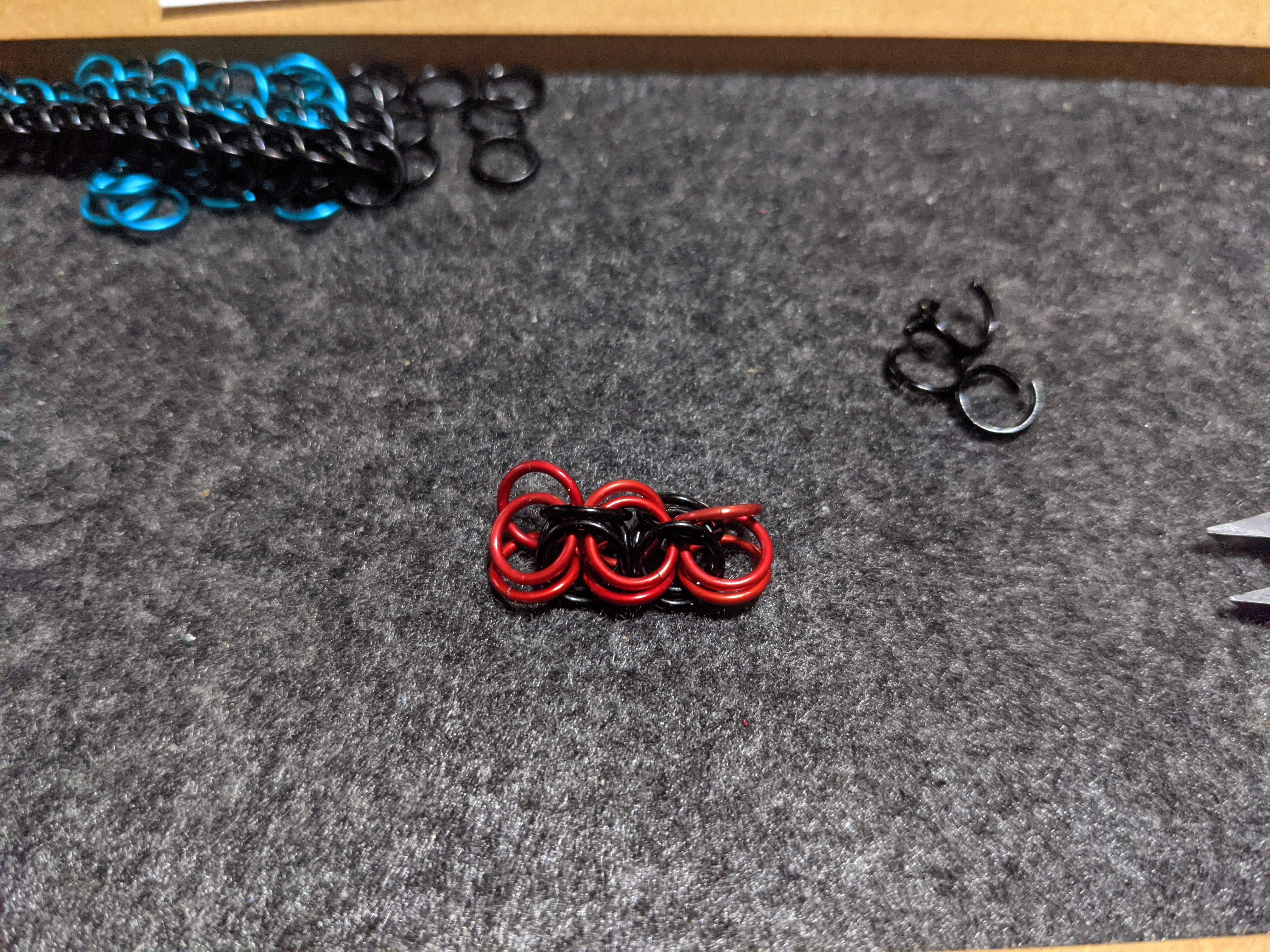

Following images were made with 18swg 1/4" rings. Only used two reinforcing rings at this size
Inverted round starter - kind of flat due to the larger AR. Add to this to build the RIR

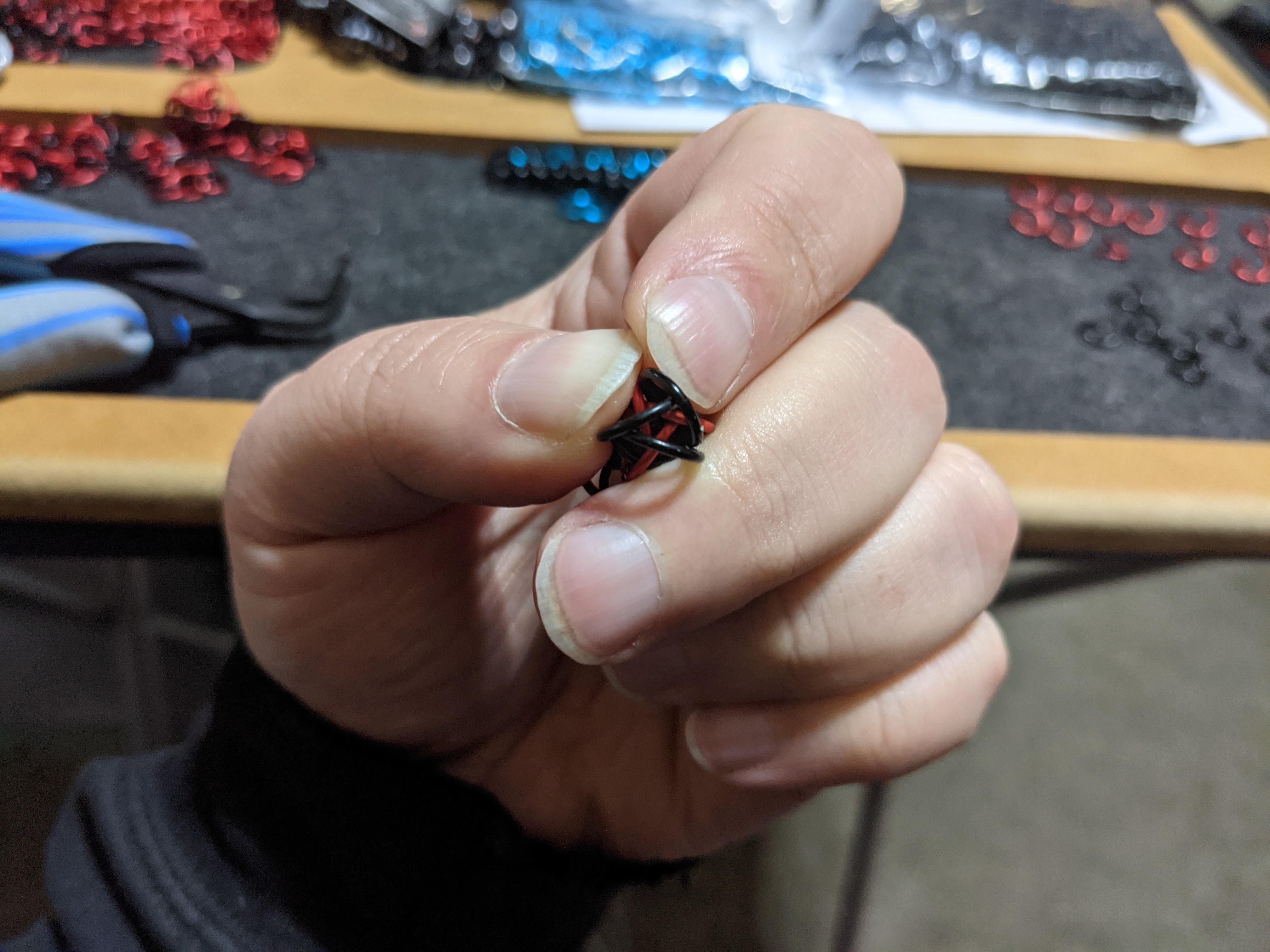

First manipulation - clockwise

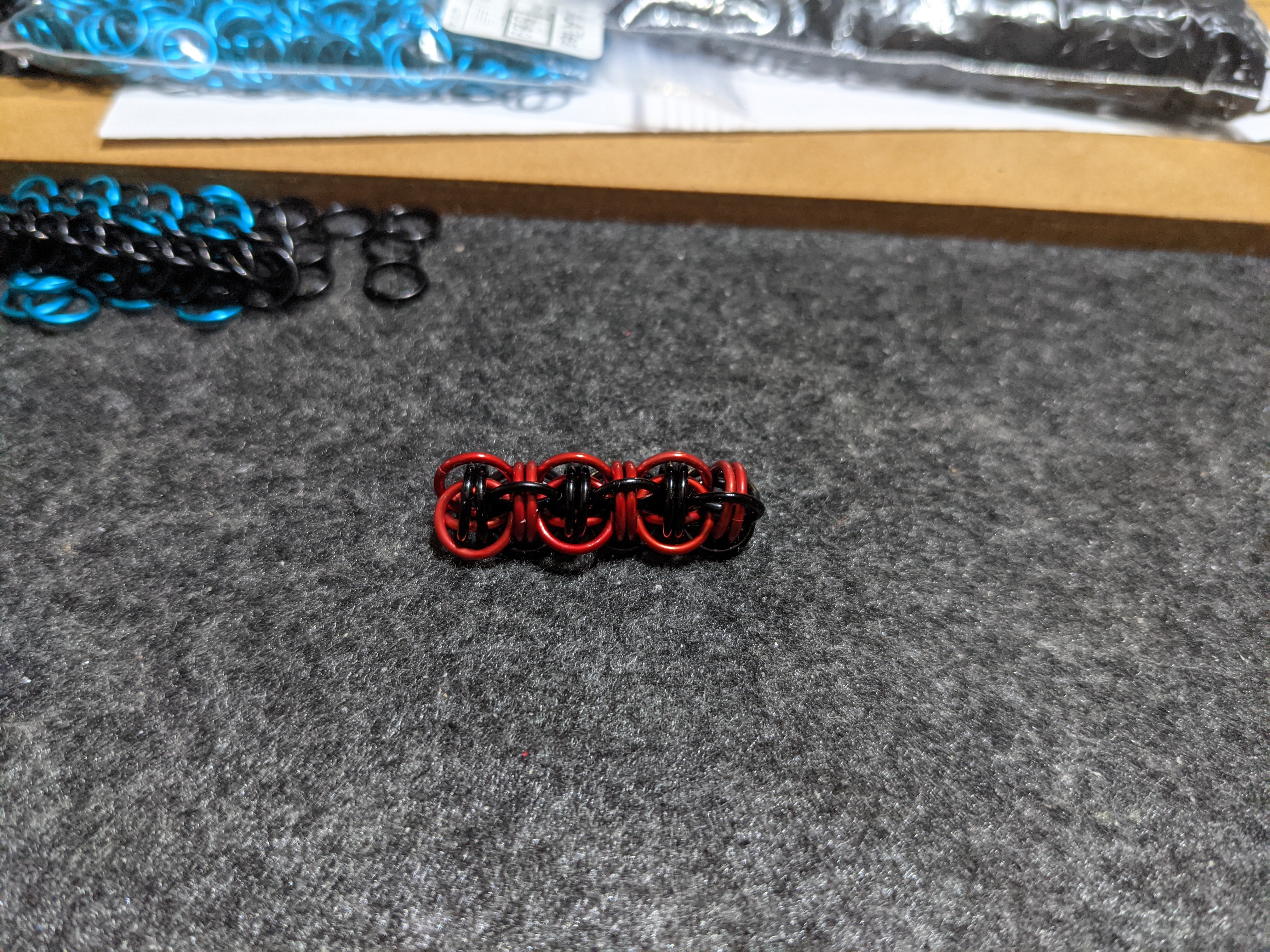

Adding reinforcing rings

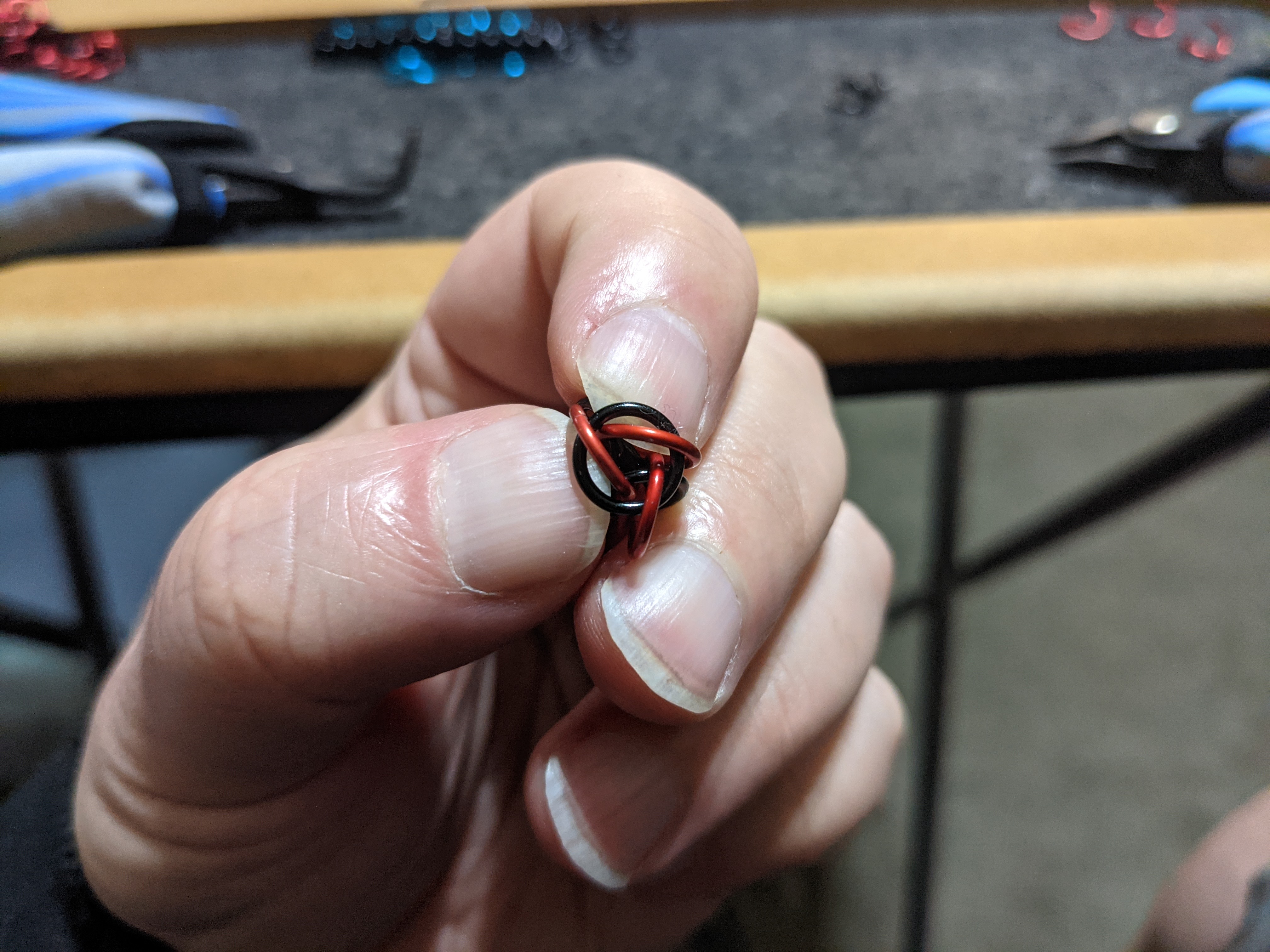

Second manipulation - counterclockwise

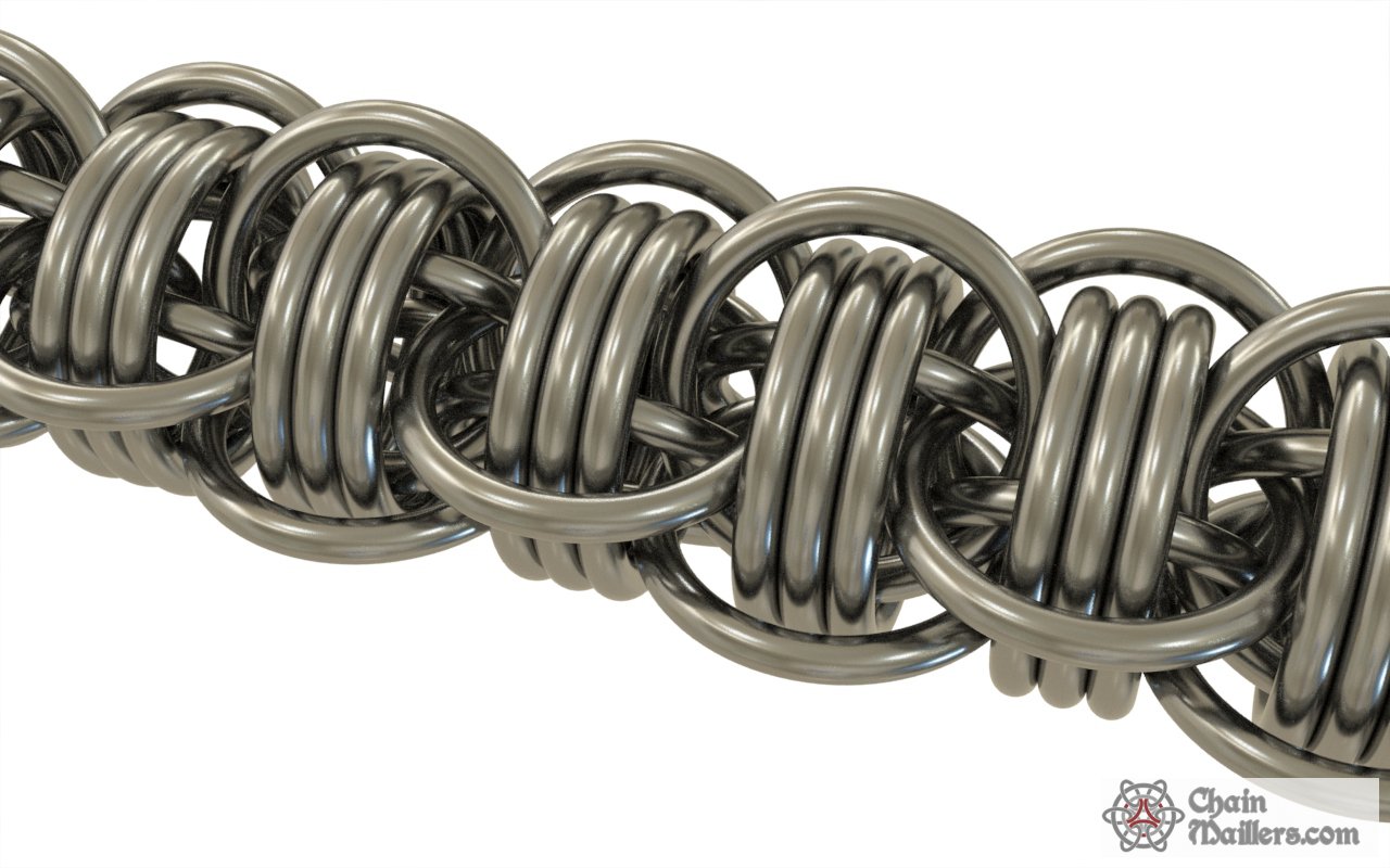

Repeat manipulations and adding reinforcing rings, eventually you wind up with this
