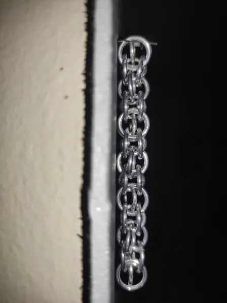

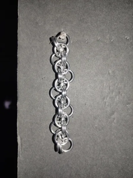

I am glad to see that someone else had success making this in a single WD. I did make it myself in in a single WD using ARs of 4 and 4.9 while still using a 1-1 chain and a 2-2 chain. I have attached some photos of it as well (sorry for the low quality, I haven't had time to edit the better photos yet so I used a worse camera).
