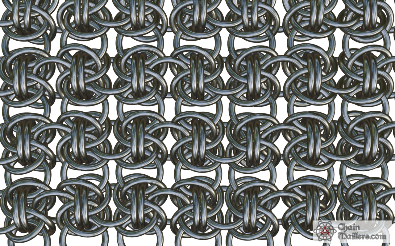

what is the difference between this and Demeter?
Sorry about the delay in getting back to you. Demeter and Deyard are essentially the same weave. The difference between the two lies in relative positioning of the box cells that are present.
In Demeter moving vertical or horizontal will always result in the alternate color:
blueredbluered
redblueredblue
blueredbluered
redblueredblue
In Deyard only moving horizontal results in the alternate color. Vertically the box cells remain the same:
redblueredblue
redblueredblue
redblueredblue
redblueredblue
Here's a visual representation of the difference:
Hope that helps :D
