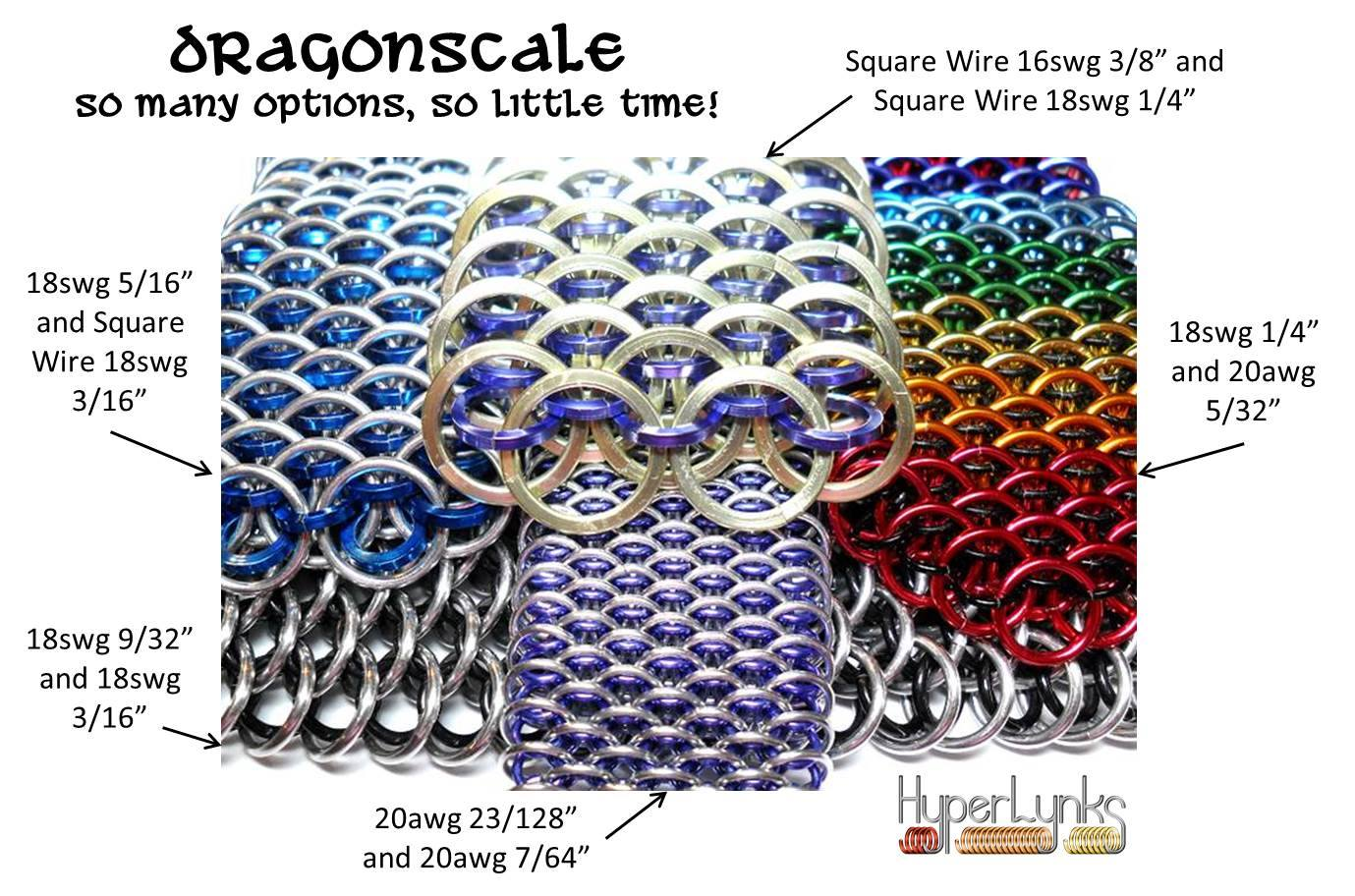

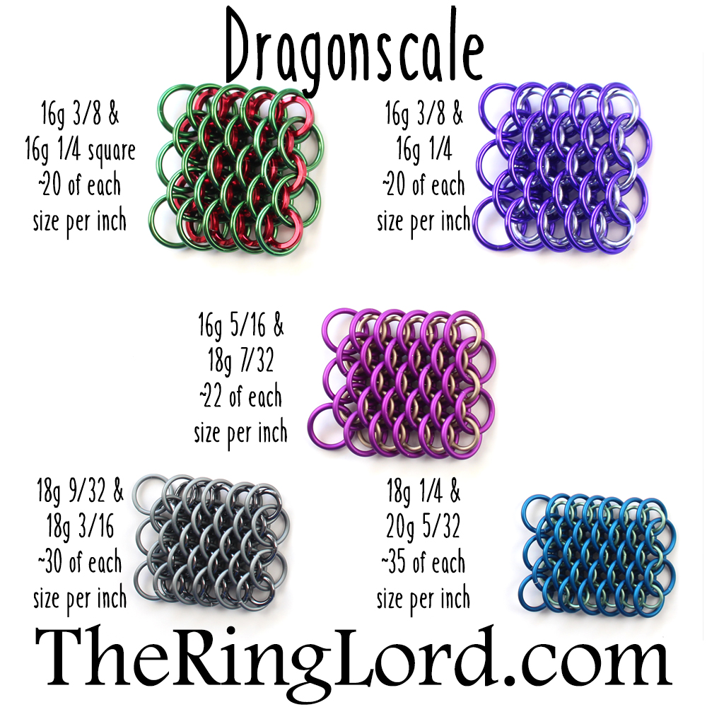

That's very helpful, thanks! So, to be clear, are you saying that the 3.9 AR that's listed under "commonly used" for Dragonscale is meant for the small rings, & the 6.1 listed after it is meant for the large "scale" rings? What about the sizes in the pop-ups - if I hover the mouse over the 3.9 AR, are those sizes in the pop-up meant for the small rings, (same idea & question for the pop-up that appears for the 6.1 AR)?
Yes, but please note that those are mandrel ARs and don't take modifiers into account such as springback or material type (which changes springback). They're more a starting point, your suppliers AR may vary. They're also only valid if using the same WD.
Dragonscale generally works as long as there is a difference of at least 2 between the small rings and big rings, so 4 & 6, 4.5 & 6.5, etc.
