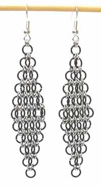

Japanese 4-1 Diamond Earrings
Japanese 4-1 Diamond Earrings - This is a fairly simple weave but the small rings make it fiddly.
Japanese 4-1 Diamond Earrings​
The project uses rings made with thin wire thus making it a fairly weak weave. However, as the finished piece is designed to dangle from an earwire, this does not matter.
For the earrings, you will need:
  • (A) - 114 bright aluminium jump rings ID 2.6mm, WD 0.81mm
  • (B) - 72 black anodised aluminium jump rings ID 3.6mm...
