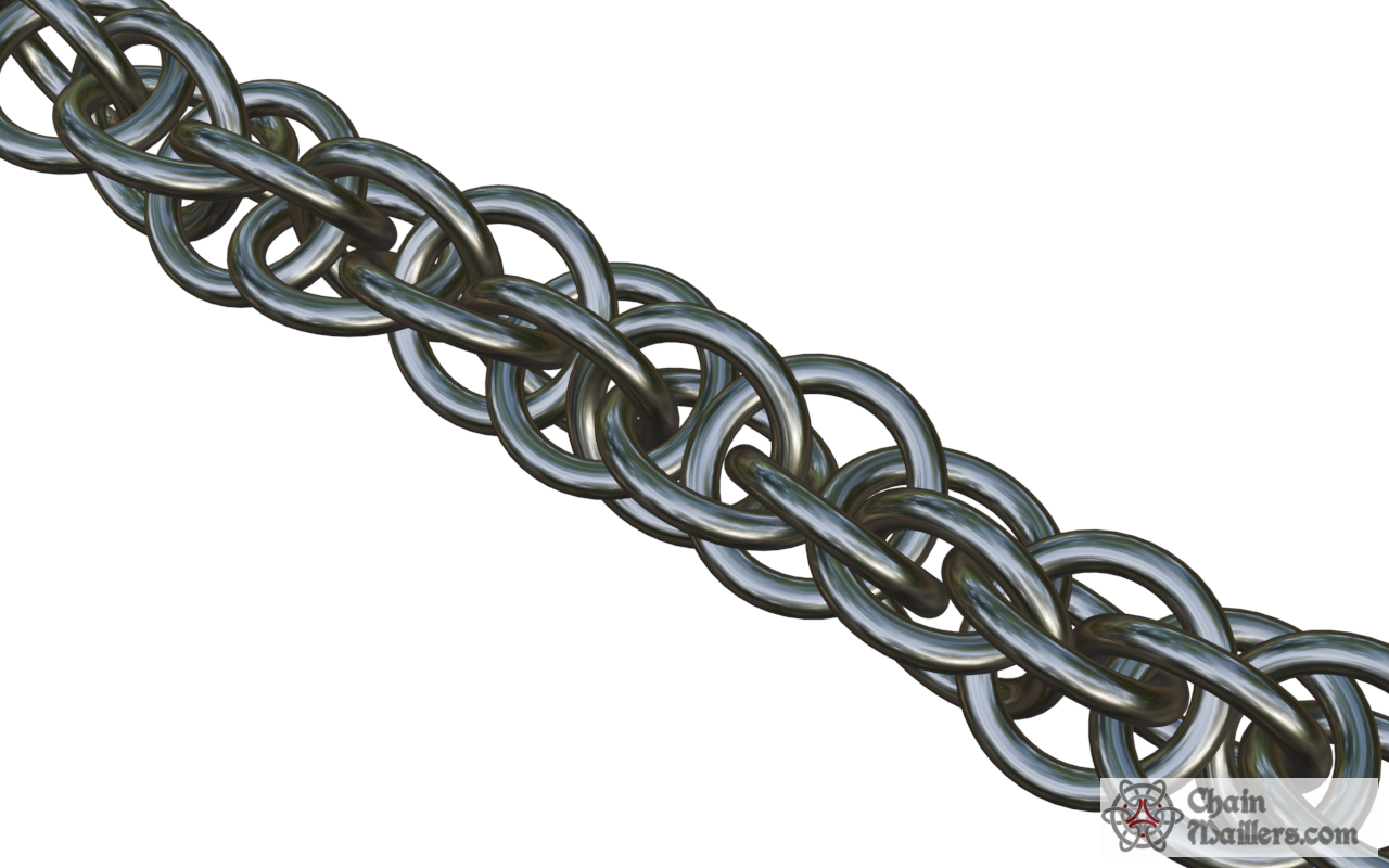

If you look at the Maillesplosion for JRC (Spiral), you can see the spiral grains present in the weave.
japanese-rain-chain-spiral-jpg.6352

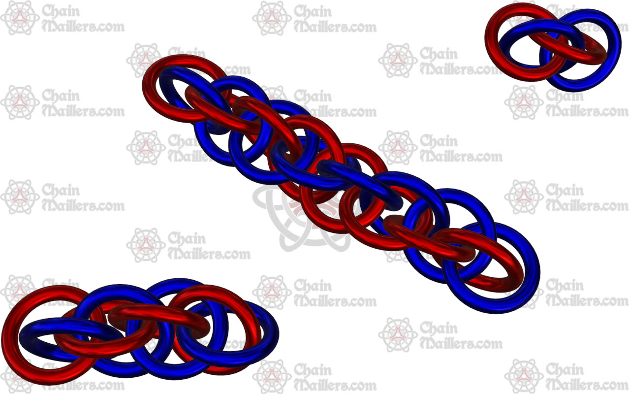

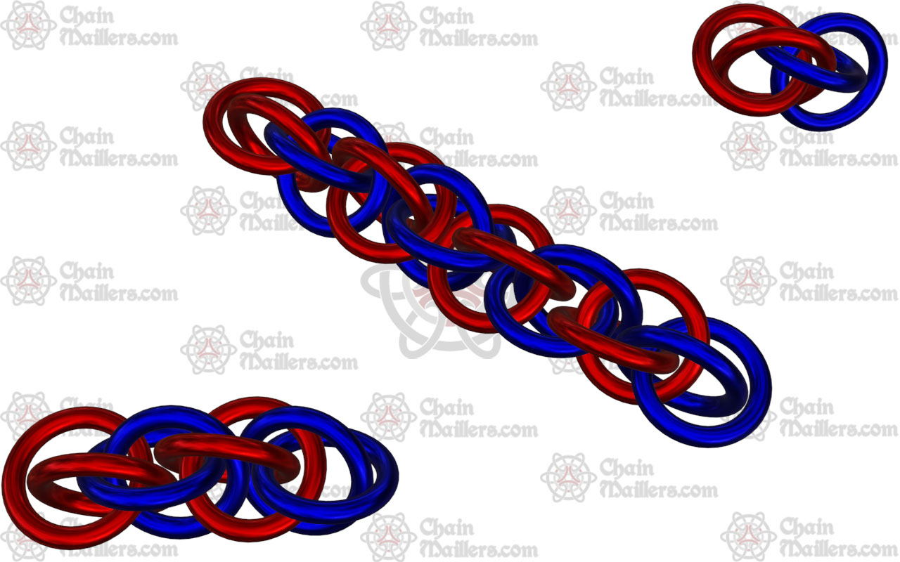

While that image is great for showing the grain, this one may help more with the construction of the weave.
All you're really doing in this weave is taking two connected rings rotating them slightly and connecting them through the two previous connected rings. Another important note is that the ring pairs need to have the same orientation each time. What I mean by that is if we say the left ring was horizontal to start and the right ring was vertical then all additional ring pairs need to be the same. You also need to make sure that your rotation is in the same direction each time.
