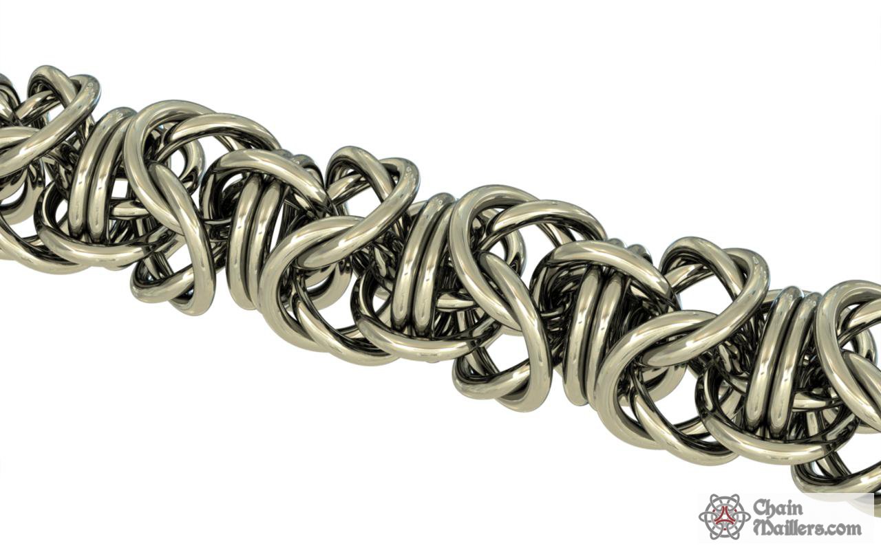

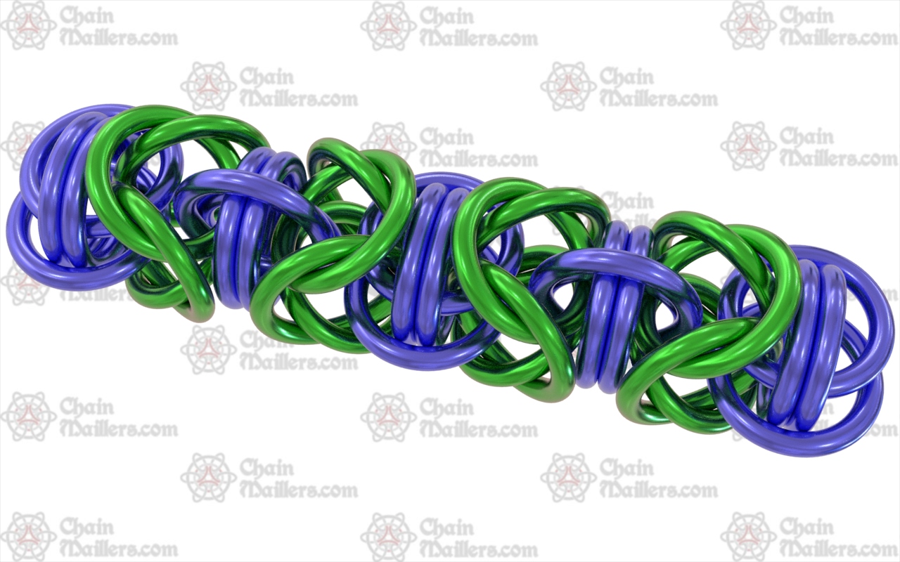

I have done this with 18g SWG 7/32 and it is tight. Can this be done in other sizes of 18g and or 16g? With it still keeping reality its shape?
There's some further discussion of this weave here:
Tahra Tahra reported being able to use 16 SWG 9/32 with success. That was with titanium and an AR of 4.85 though.
If 18SWG 7/32 is tight, you should be able to go up a step or two for a slightly less tight chain. I haven't tested these, but you could potentially use 18SWG 15/64 or potentially 18SWG 1/4. It really depends on the actual AR of the rings though, too far out and it will get "floppy".
