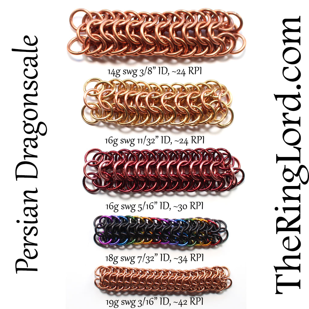

This thread is for the general discussion of the weave Persian Dragonscale. Please add to the discussion here.

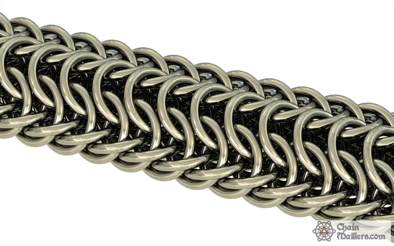

I'm curious if it's possible to make a sheet version of Persian Dragonscale, using this chain pattern/weave, like how you can with a chain of EU 6 in 1, or normal Dragonscale. Anyone know if there's a way to make a sheet version of Persian Dragonscale?
Interesting, at least I can now stop puzzling myself on how to expand the chain into a sheet by trying to join two of the same pattern/weave at their sides! When you say "traditional sense", is that a reference to the usual sheet patterns/weaves of Dragonscale, or to the traditional Persian sheet patterns/weaves? Also, knowing that this chain can't be used as a foundation for a sheet version of Persian Dragonscale makes me wonder if using any of the traditional Persian sheet patterns/weaves work, like how EU 4 in 1 is for several Dragonscale patterns/weaves.Not in a traditional sense. It’s a tube with two classical weaves.
You have to make several changes to the weave to make it repeat itself with only elements aready present.
