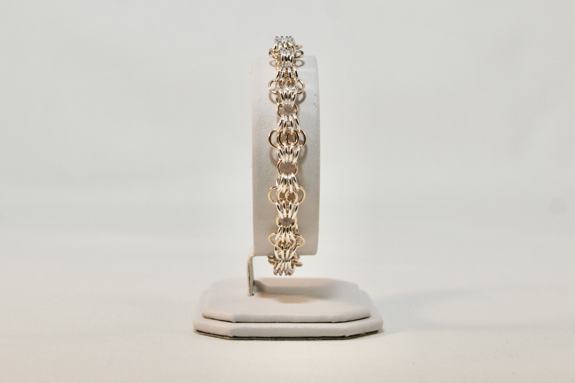

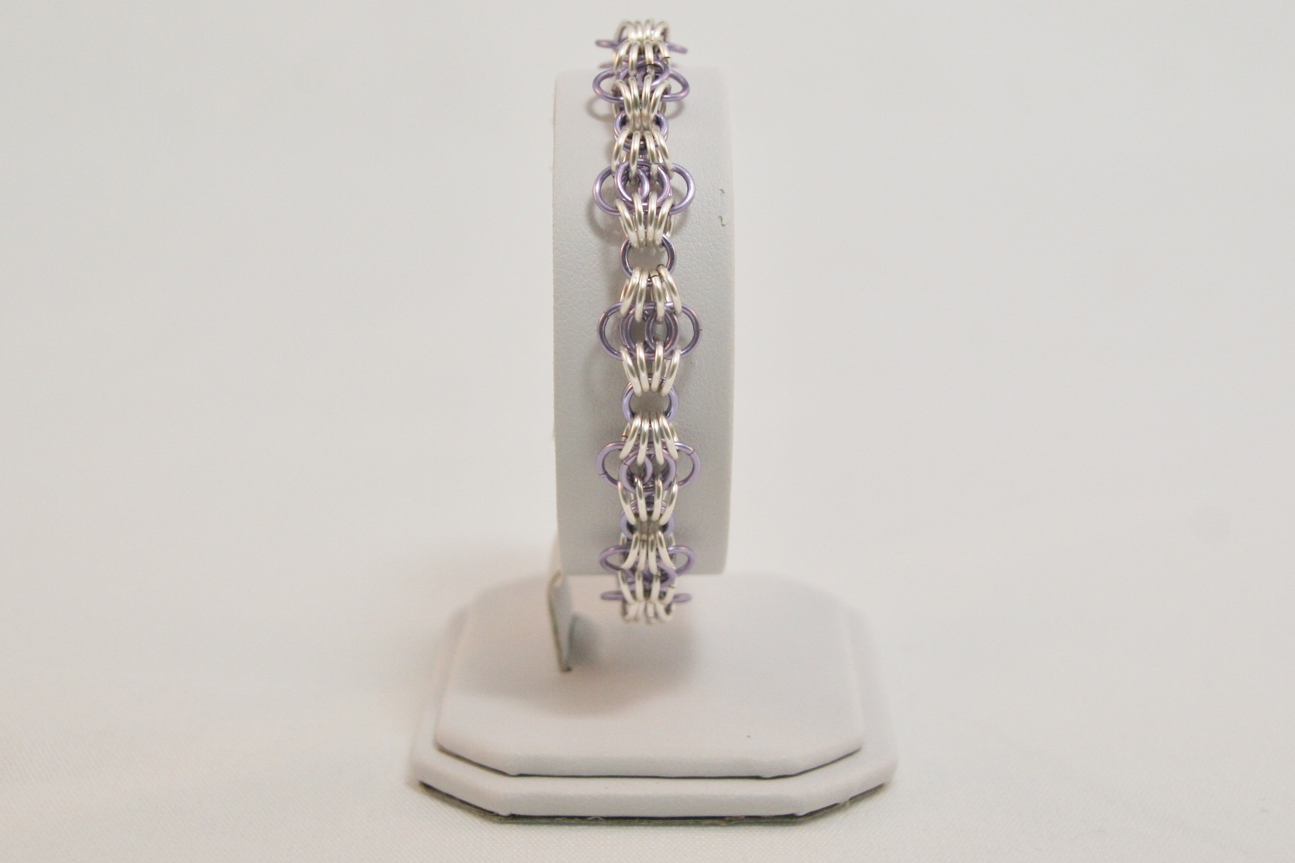

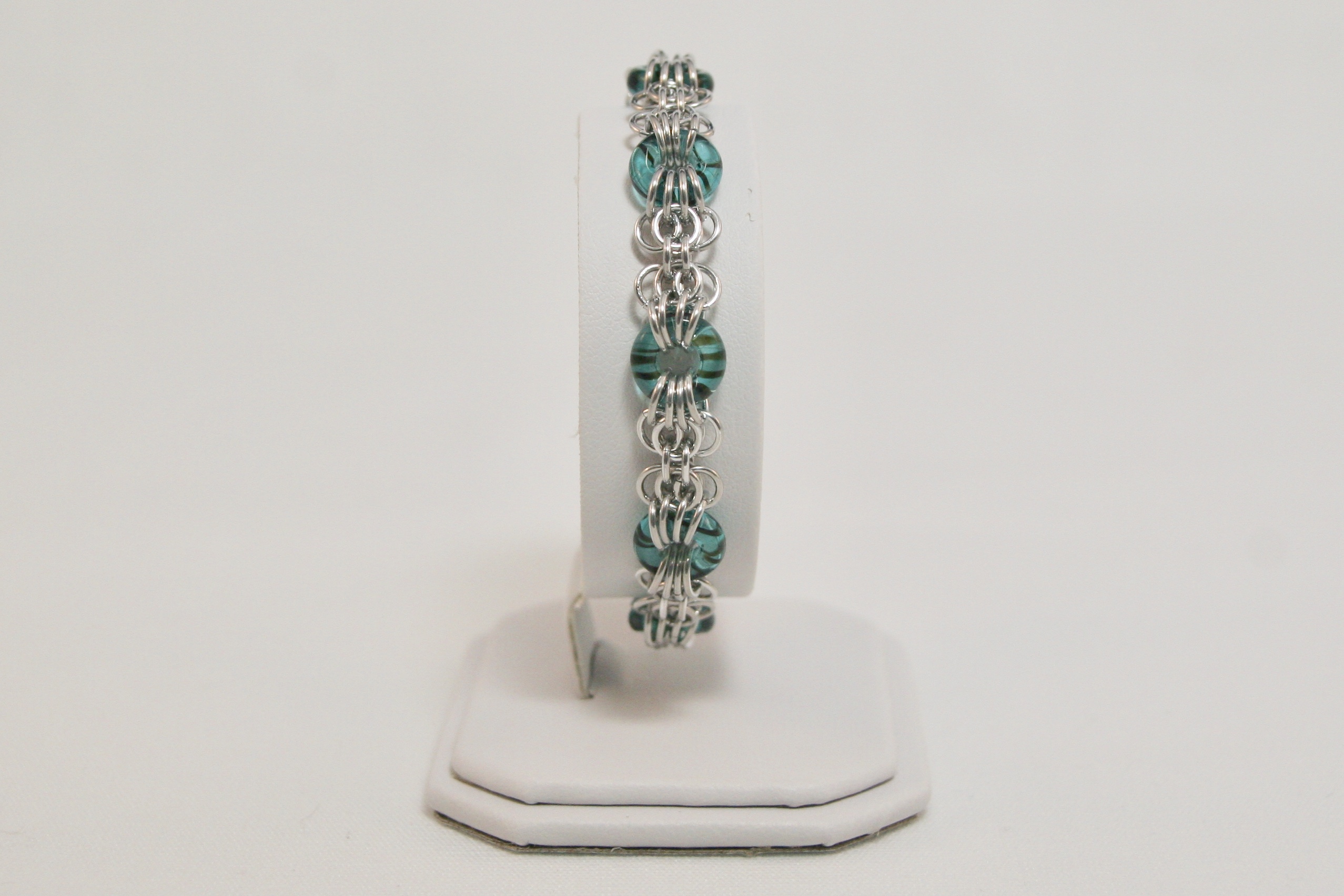

I can't seem to find the weave that I thought was called "butterfly" (with a different variation shown in the 4th photo with the beads) on this site. I've included pictures below, but does anyone know what this weave is officially called and if it is in the Maillepedia?

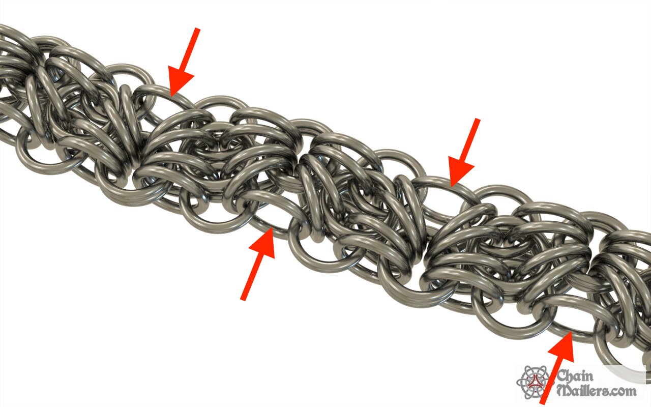

Thanks for your response! I'm not sure what you mean by "non-contracted", but my first three photos look exactly like "Sunrise" but without the ring that pulls the weave in tighter (the rings that I pointed to in red arrows).
The rings that you have arrows pointing to are the ones that cause Sunrise to be a contraction of Butterfly (or Butterfly being a non-contracted version of Sunrise).
They basically shorten the length that the chain would be if they were not present, contracting it.
You might be surprised at how many weaves this applies to 😁
Rachel E.
Thanks for your helpful information - I guess it's true that there's no limit to the number of possible weaves!!
I should probably clarify further as my explanation was more geared to the discussion at hand. Sunrise would be a contraction of the weave that you did in your first 3 pictures, which is technically neither Butterfly or Sunrise. I believe that it does have a name, but it's escaping me at the moment
In our nomenclature (which is still being worked on), the weave that you did in the first 3 pictures uses modified Celtic cells (the 4 additional vertical rings are the modification). Butterfly uses tethered compound cells (which are made up of a mobius and 2 modified 2/3 Celtic cells).

Wow, okay, I think I understood most of that!!! And now I fully understand what you meant by,
"Out of your pictures, the beaded one is the closest to the weave named Butterfly as listed on MAIL (the difference is that the beads would be 3 ring mobius)"
