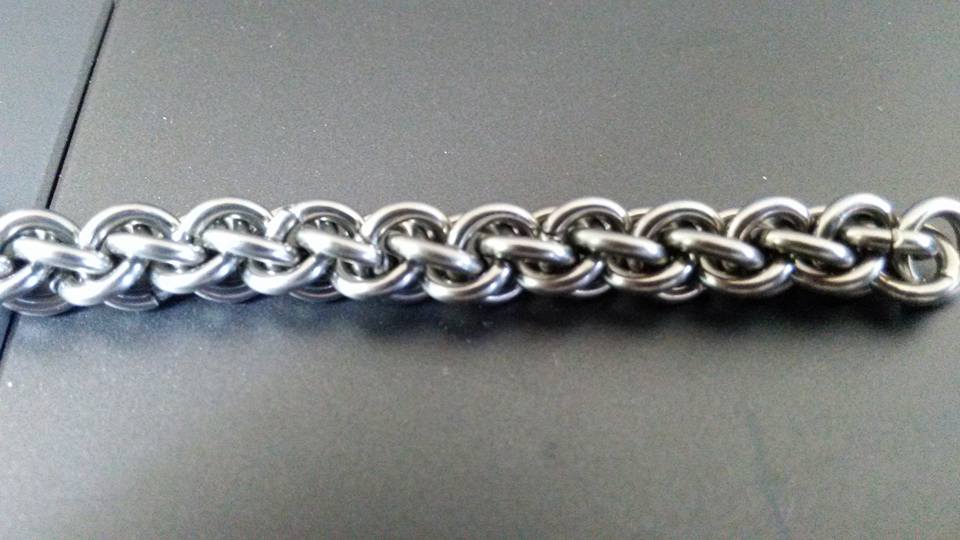

slightly blurry but it flexs all ways and is uniform. now I need to get the right mandrel and cut all my aluminum. :)

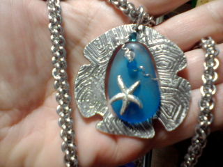

OK I found yet another JPL tutorial that I think *finally* made it make sense to me. I now have a chain containing over 1000 rings completed. I will use some for the necklace in the attached photo. The rest...? The tutorial is http://alchemistsvessel.blogspot.com/2012/09/jens-pind-chainmaille-photo-tutorial-in.html
