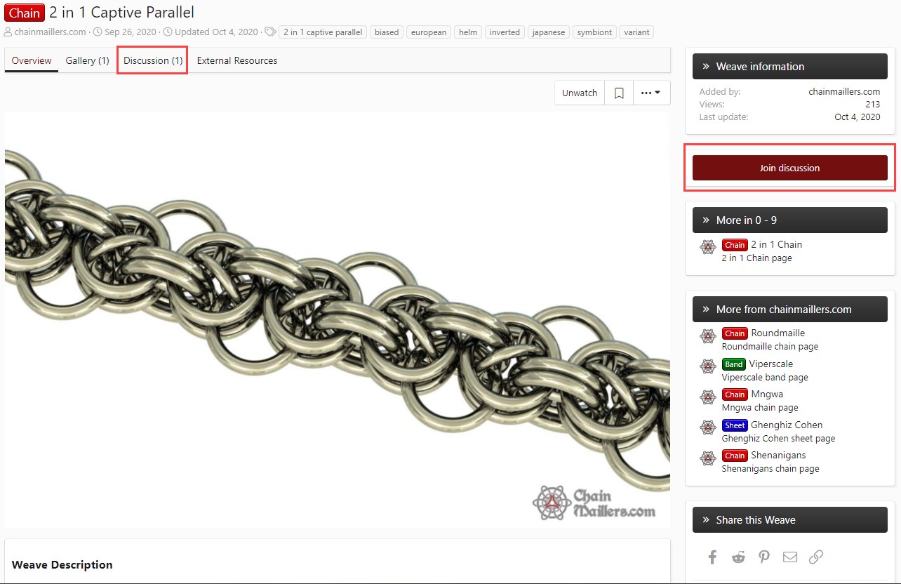

Was actually thinking about this. While this thread is a great idea, it should probably only be used for weaves that are not currently in our Maillepedia. Each item in the Maillepedia has an associated discussion thread specifically for that item. Those threads would be the best place for specific ring information, per weave, to be placed.
Please make sure, if posting ring sizes, that you also include as much ring information as possible:
  • AWG or SWG
  • Wire Diameter
  • Inner Diameter
  • Actual Ring AR
The discussion page for each weave can be reached from the item page by clicking on the 'Discussion' tab or clicking the 'Join discussion' button.
