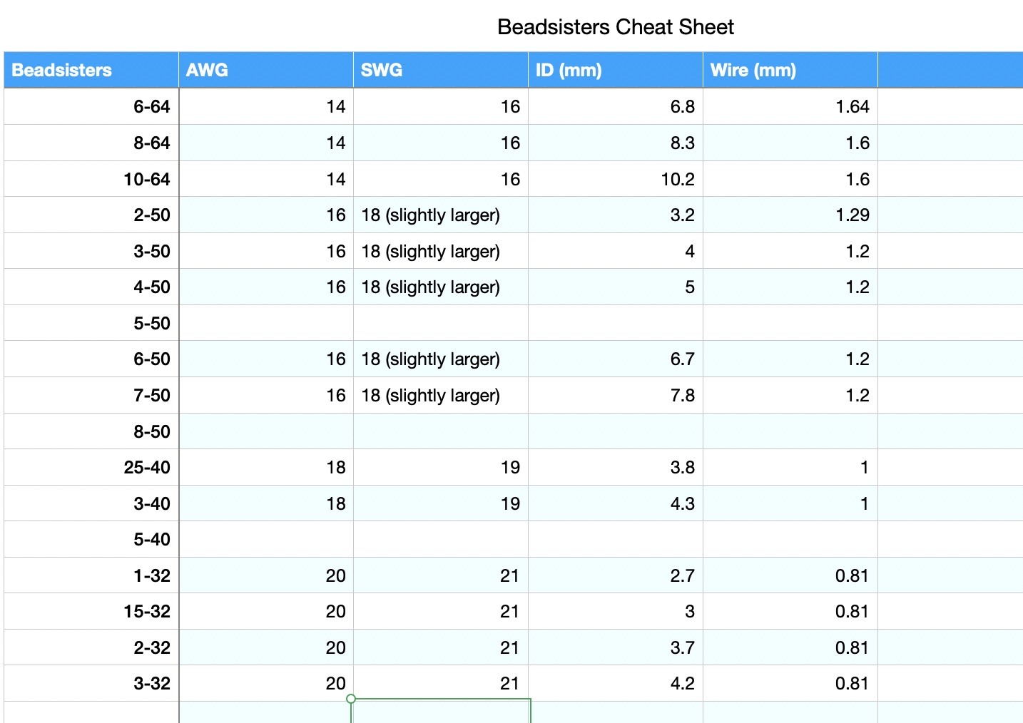

Has anyone developed a conversion chart for Beadsisters sizing notation to 'standard' chainmail sizes? I learnt with Beadsisters and am having to relearn what I need to make things with standard notation.

That is a good point Mr Mod. My question was more, if I know a project takes 7-50s, but have no 7-50 bags left over to get the measurements off, how will I know what size they are? 7-50 is just an example, as I actually have lots of 7-50 bags over ;-) I learned to make a bunch of things knowing 'this takes lots of 6-50s and a bag of 6-64s' but I don't have any references for what those actually are any more.

Hi Sabin -I was organising my rings today, and have come up with the following based on what was on the B Beadsisters packets I had left - apologies to them for any mistakes. Hope this helps people!

I'll give you credit, Leverett. You've got more patience than me. What an odd naming system. BBB used a system of letters and numbers. L18, for example, meant 18 gauge wire, 1/4mm inner dimention. Beadsisters' labeling system appears to be totally unconnected to anything, not giving you the tiniest hint of wire size, much less ID. I'm glad you've got that figured out. Happy weaving!

I would love to get a copy of that spreadsheet is it available or is it now up on this site. I have always tried to figure out how to read them and like you the actual size, but I don't understand the way they have listed it.
Sorry its taken so long, but we were able to reach out to Beadsisters and get the following information from them regarding their ring sizes:
