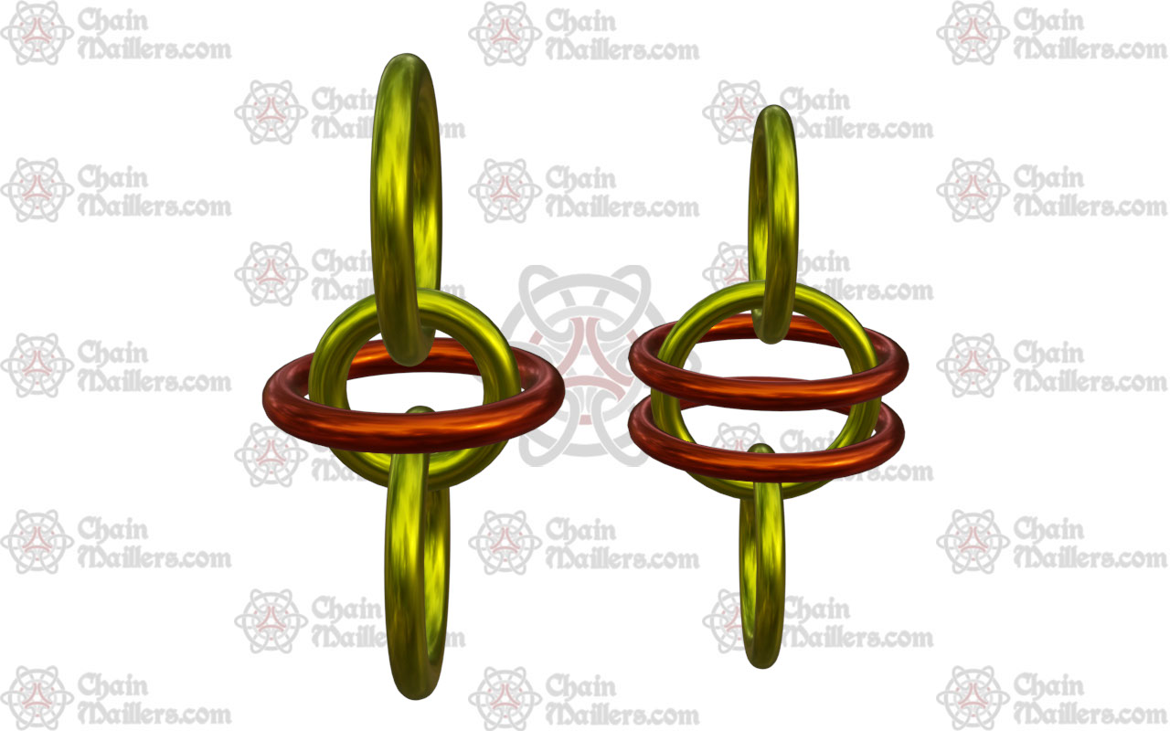

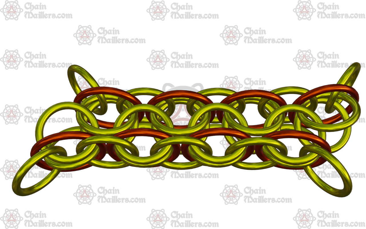

I don't know that I would personally include ladder in that grouping. If you take away the central rings in Ladder, you're left with no connections. Ladder is essentially helm chain, but with 2 mirrored orbital rings (orange) instead of a single orbital ring.
Yes, it can probably be tubed in much the same manner as those you mentioned, but the central ring of the terminated cells (yellow) would need to be stacked first.
Render note: These are rough renders (there will be collisions) just to give a general idea of the concept. AR's used ( 6.1, 7.7) would most likely not work in the real world (especially the gridlocked version) and would need to be refined.
Proto chains:

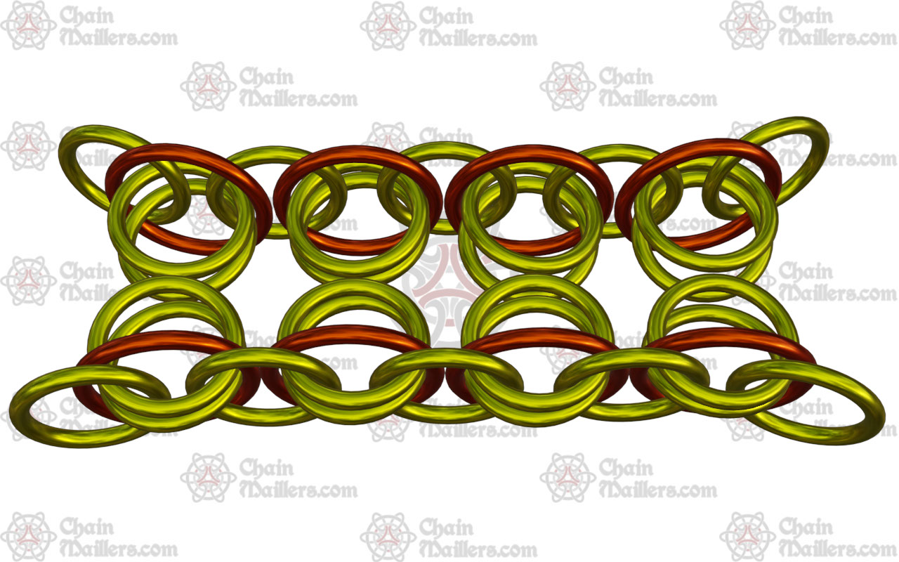

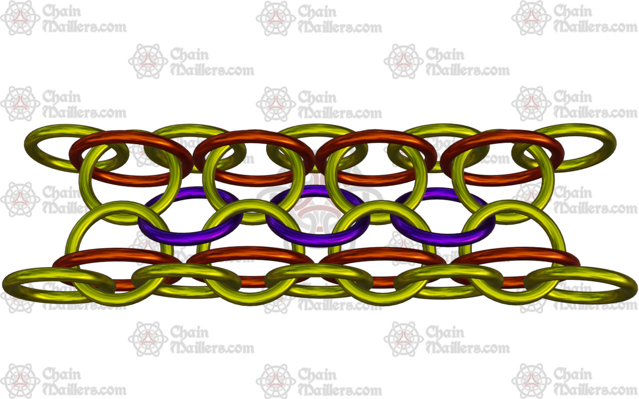

Ladder Tube 4 in 1:

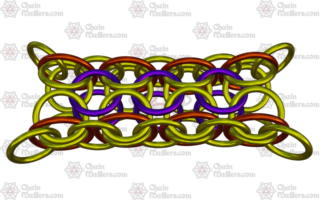

Ladder Tube Gridlocked:
Or did you have something else envisioned? ;)
Proto chains:
Ladder Tube 4 in 1:
That’s exactly what I envisioned, but since it’s listed beyond 8 on MAIL and if I found it anywhere else, I don’t currently have the capacity to make tests in that range, but since you provided much lower AR, it might be feasible for me.
not shown is Ladder stew and Ladder.
What we can see from the renders now is that the ladder tubes are just mangled IR variations, and as such - with their low usefulness - I assume they won't show up in the library?
Maybe one day. What you or I (or anyone) considers useful does not negate the fact that these are a unique sequence of cells and connections. I don't particularly find taco's useful, yet they still exist ;)
