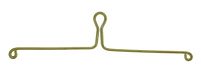

A tie-clip would be more challenging than just a tie chain... but with a chain you could simply cut a blank from sheet metal, and file or polish, use it for the back side shaped like " __∩__ ", to fit over the shirt button, and drill holes in the ends of the blank to connect a chain. Or, you could feasably use a relatively heavy gauge of steel wire (16? 14?) to bend something into a similar shape. Then just weave a short length of chain between the two. Would make a great piece, really. Lots of variations possible.

You can also make a tie chain style that has a "hanger" that goes over the button. There are findings for these, but it's easy to make your own. using hard wire, shape it like an ohm symbol Ω with longer "feet" with loops that the chain attaches to on each side.

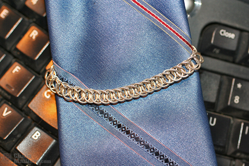

You can make the hanger style pretty easily. Here is a tut for a simple one - tie chain
I have a picture of one I made but not of the back in the media area :)

Ginger and Melody both did a better job of explaining that than I did, but their ideas are what I was getting at...

I really love this idea and now I want to make one for my husband. I really like the one with a single bead that was posted in the link.
