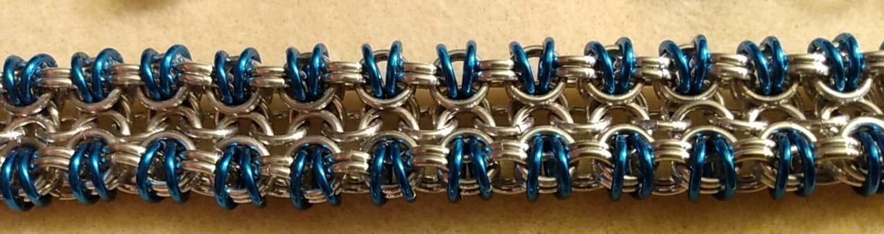

Thank you for your help with this. I made a practice piece that I am going to turn into a bracelet and I did this in 18g, I am going to try it in 16g to see how wide it ends up, and I want to make a slight adjustment, not sure if it will work or not but I will see. Here is a picture of what I already have,
Looking very nice!!! Great color combination.
I do need to inform you that if you were going for BBTB, it looks like you have a few extra rings in there. Instead of Byzantine segments, it looks like you have two "half" byzantine segments overlapped and then bolted.
If you were going for your own variant, then Maille On! :D
Edit: Nevermind, I screwed up, I see you're doing Beez Stew, not BBTB. Wasn't familiar with that one.
Byzee Bees to Butterflies. I forgot you mentioned Beez Stew, which I wasn't familiar with. I edited my previous post. Your bracelet is a fine example of Beez Stew :)

Hey MrDeranged, when you get the chance can you take a look at https://www.mailleartisans.org/weaves/weavedisplay.php?key=1075 and tell me if that is what I did from my tutorial that was called Beez Stew? Based on the picture above?
I just looked at the instructions and it is done slightly different that what I have done above so I am still not sure if they might be the same weave??
Your picture IS Beez Stew. :D

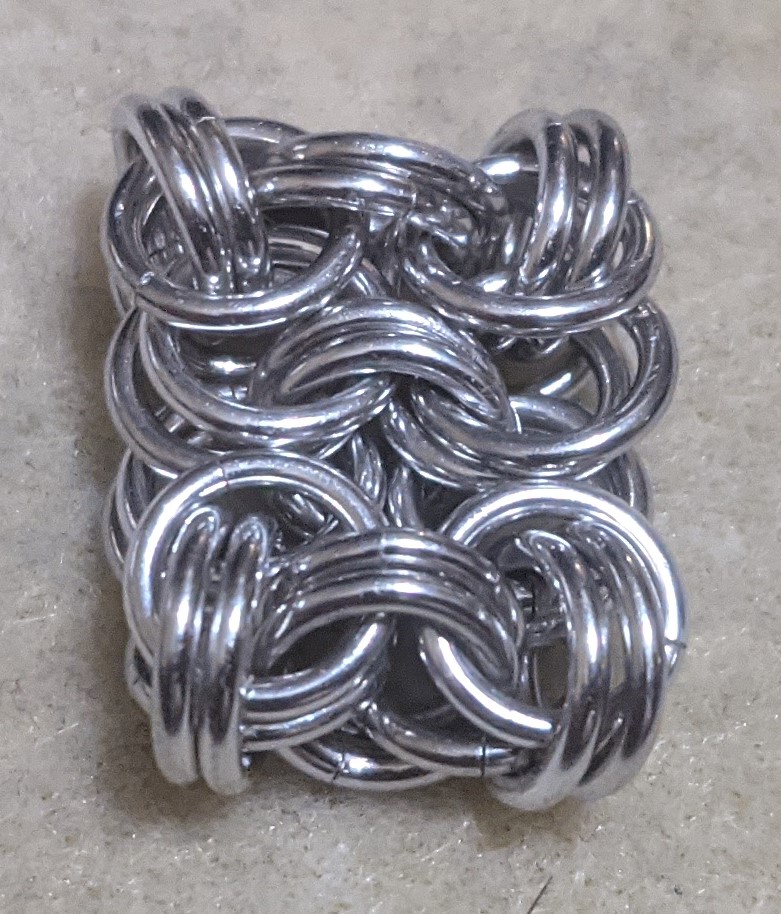

All three of the weaves being discussed (Byzee Bees, Byzee Bees to Butterflies, Beez Stew, and Flat Byz 4in1 Tube) are all, at their root, Byzantine.

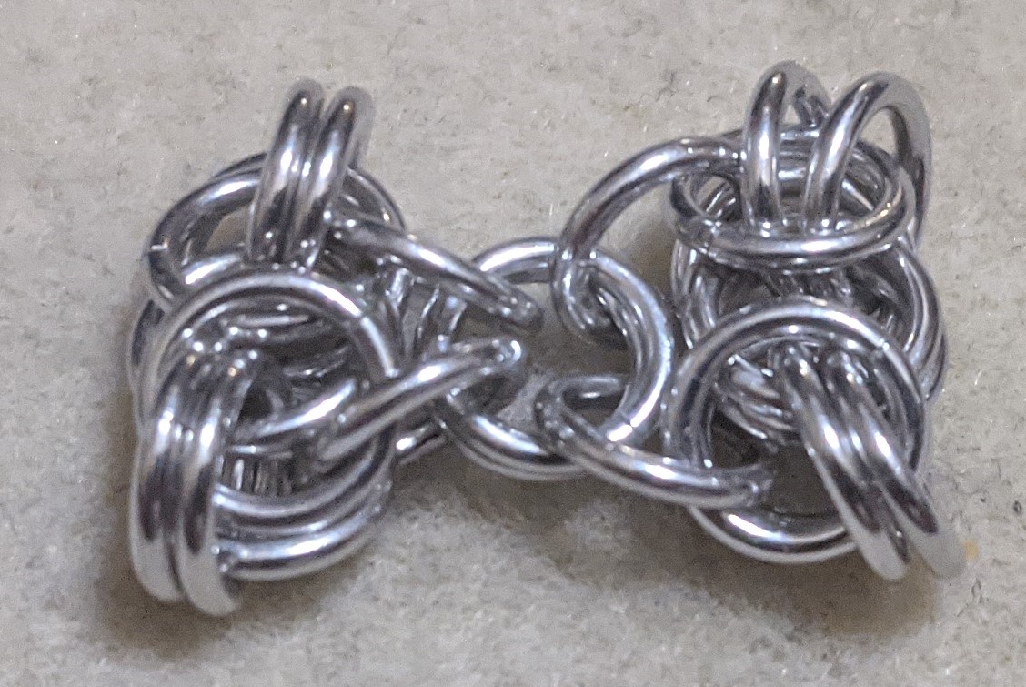

Crappy picture explanation incoming (done with rings on hand, click the image to enlarge the crappiness ;) ):

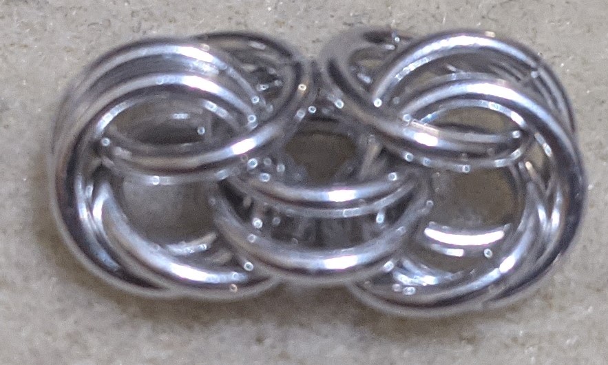

  • A unit of Byzantine can be characterized as two connected, mirrored box cages.

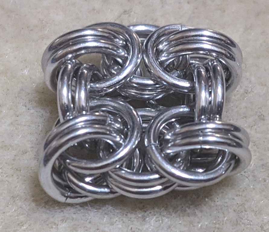

  • Byzee Beez - tethers placed through the inverted rings in a byzantine unit which are then tethered again.
  • Byzee Beez to Butterflies - units of Byzantine bolted (through the inverted rings) to adjoining units of Byzantine.

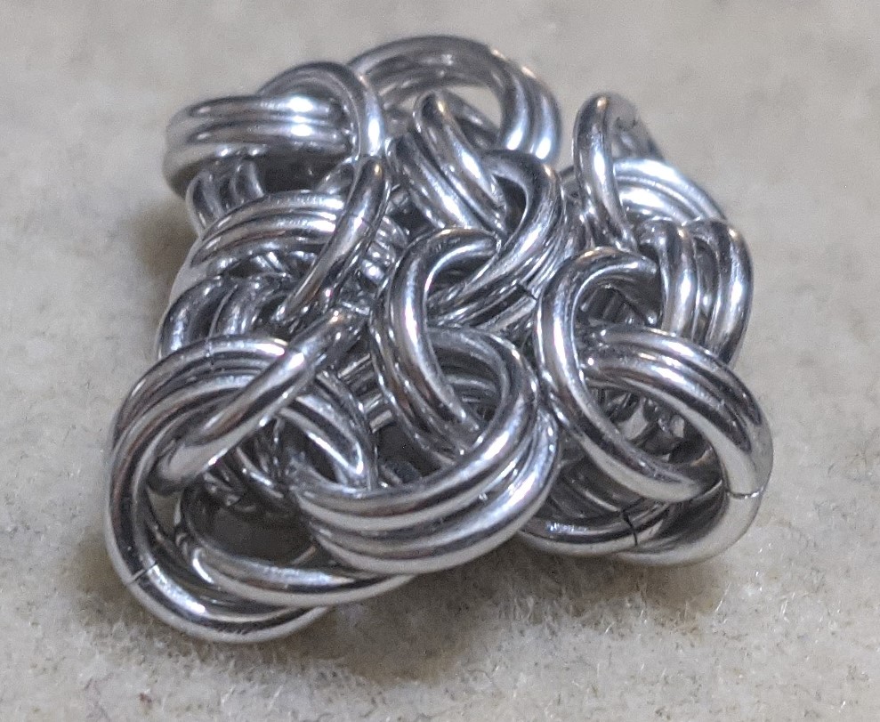

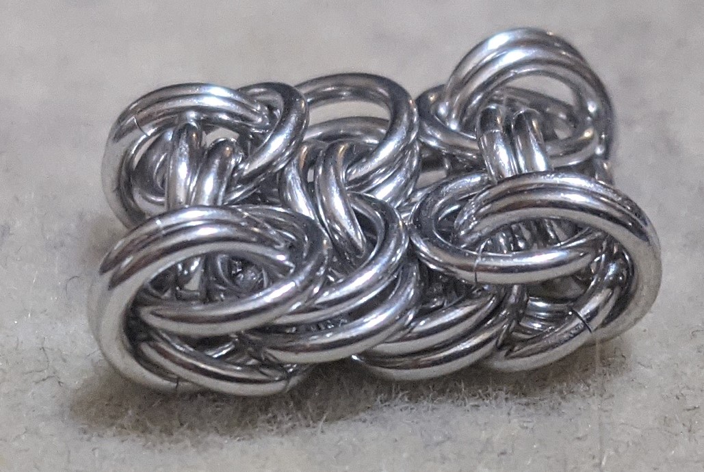

  • Beez Stew - Overlapped 2/3 segments (one box cage and a connector ring) of Byzantine (the connector rings of the opposing 2/3 segments are overlapped). Cages are tethered to adjoining cages and the overlapped connector rings of the 2/3 segments are tethered European 4 in 1 style.
    Top view (Byz 2/3 segments are symmetrical)
    Side view - you can see that the connector rings are overlapped

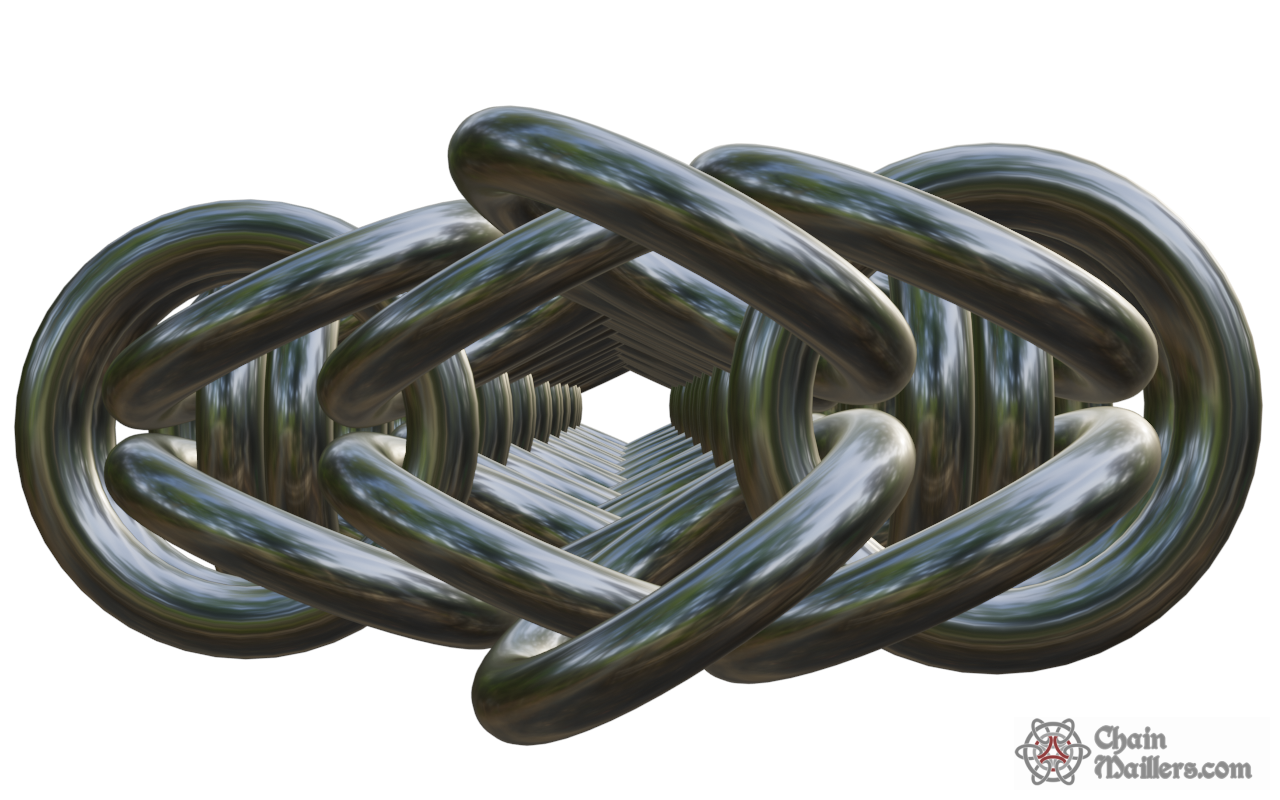

  • Flat Byz Tube (4 in 1) - Two mirrored B^ chains, offset and interwoven.
Cross section

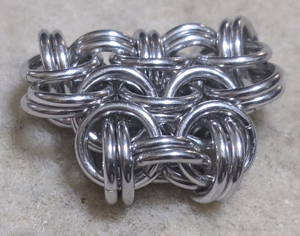

  • Flat Byz 4in1 Tube - 2/3 segments of Byzantine where the connector rings are joined (European 4 in 1 style) to opposing adjacent 2/3 segments. Cages are bolted to adjacent cages.
    Top view (Byz 2/3 segments are asymmetrical)
    Side view - you can see that the connector rings are joined to each other European 4in1 style.
Hopefully that helps show the differences between the weaves. :D
That's not flat byz 4-1 tube.
There was an error on this site before yesterday - that is just a beez stew variant
