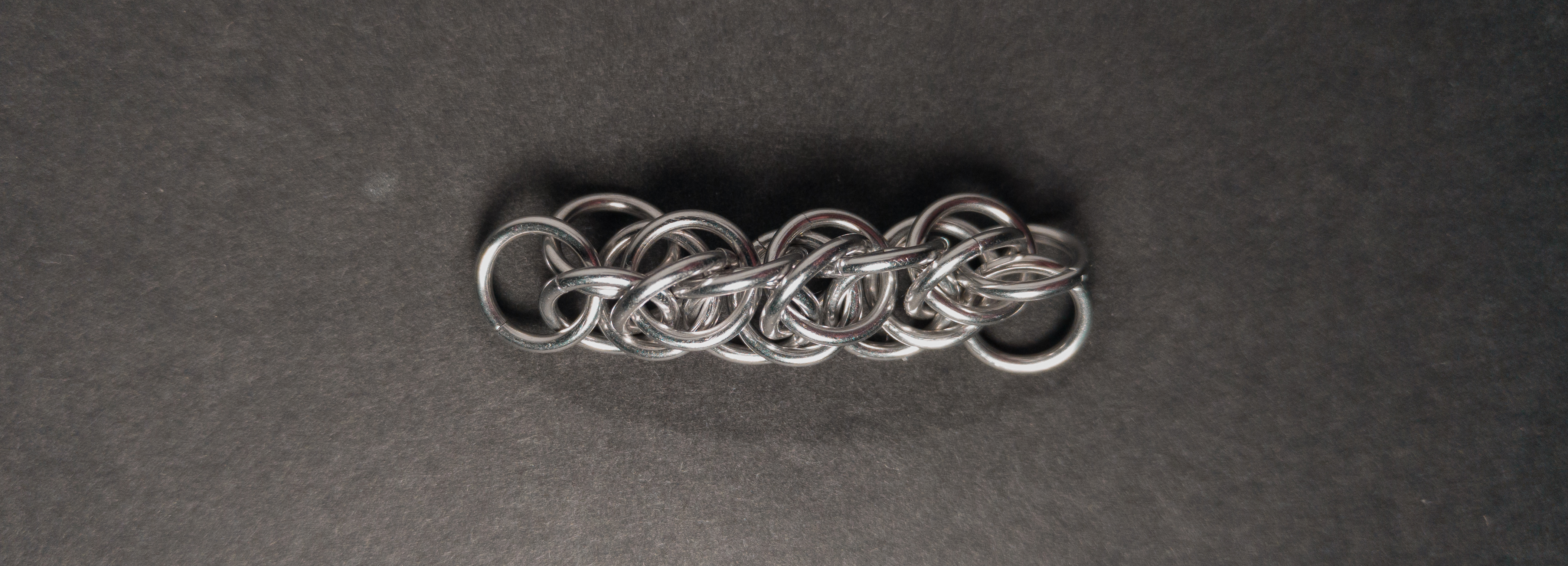

I'm not sure what others might think, but I'm fairly sure that this is a sequence of connections that hasn't been described before and, I at least, consider it to be something "new". There is one other thing I would like to see.
Can you take a "flat" picture of the other side (bottom) of the weave?
I'm assuming that it should look something like this:
As It's not found at a deep search on MAIL, and a cursory search at the rest, I agree that we can assume it's new.

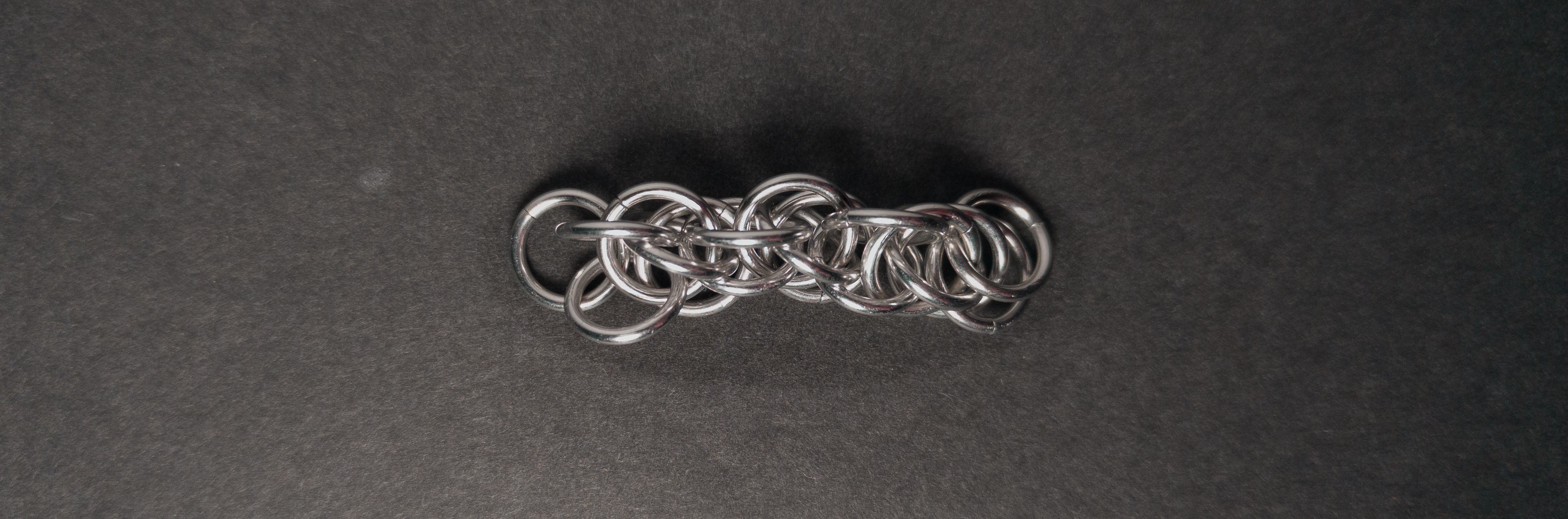

Sorry about the lack of quality and new photo, I had to make the item again with less rings and use a worse camera. I have included a top and bottom shot to help make things clearer. Also, from my experience your render is accurate about the bottom of the weave. Please let me know if you have any more questions about it.

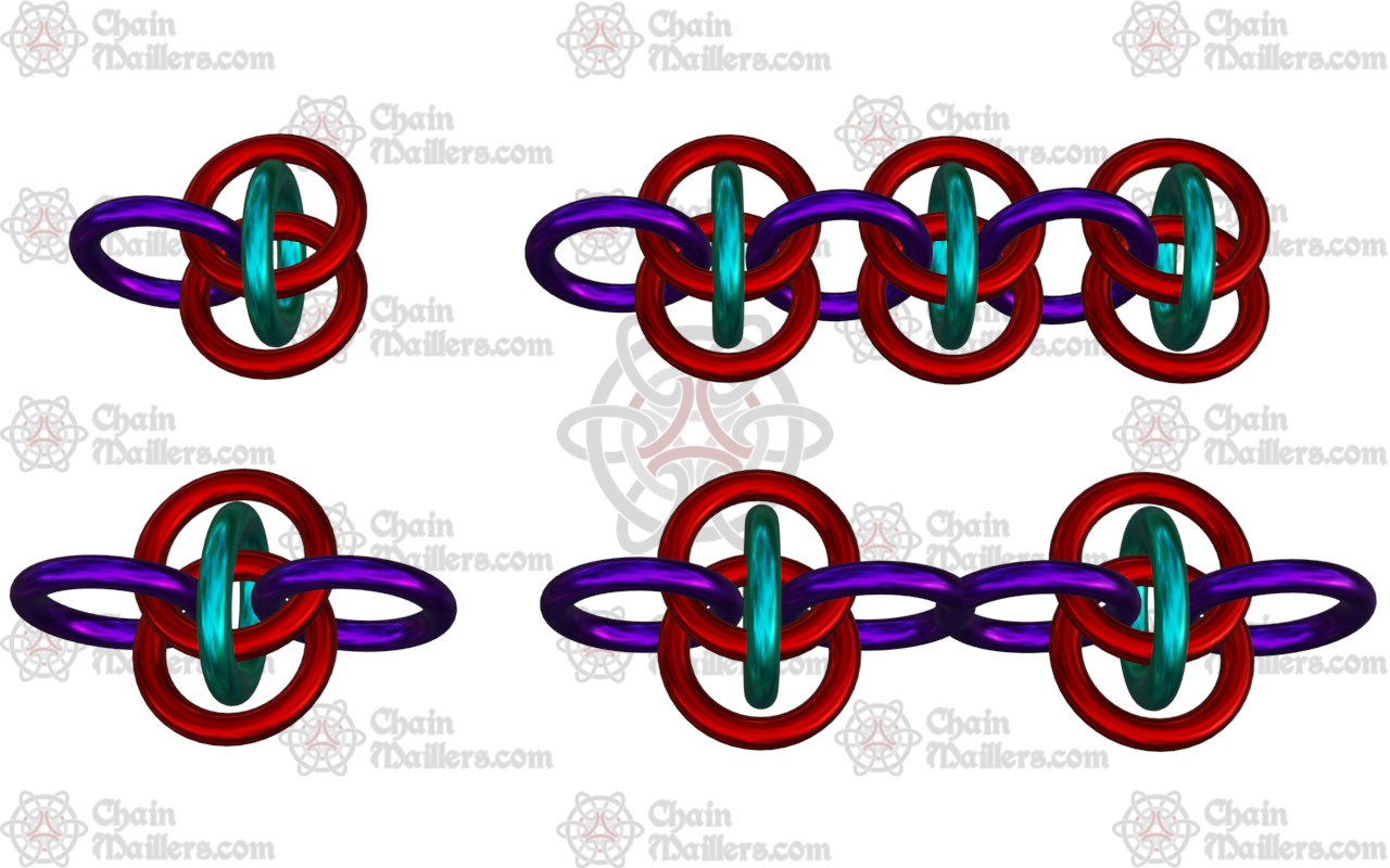

Dolphin is a variation of Rhinos Snorting Drano with two added rings around the middle and those rings are folded with old connection rings to make a Dolphin unit. Units are connected with double rings.
The following image shows what we consider to be the base cell (which directly translates into a chain of RSD) and a terminated segment of RSD (as it can not be directly translated).
Please note: A direct translation is a duplication of a cell and movement without rotation along a single axis (This is a primary concept in Cellular Chainmaille Theory - CCT)

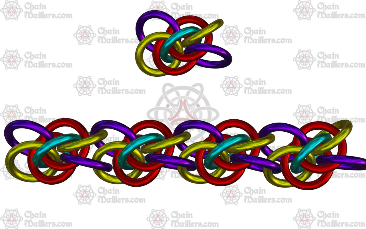

The following image shows the difference between a terminated segment of RSD, a terminated segment of "Kora Twisted" (which is an expansion of RSD), and a segment of Dolphin (based upon the picture provided for the weave at MAIL).
Please note: "Kora Twisted" was described as different weave (not accepted as a weave at MAIL) by the same person that described Dolphin. In the MAIL image there are 3 different configurations shown. Based on our classifications, the top, would be considered "Kora Twisted", the middle would be considered "Kora Twisted Segmented" and the bottom would be considered "Kora Twisted R3"

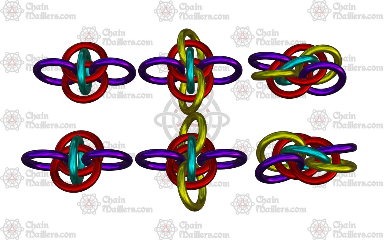

The first problem with Kora Twisted segments is that they introduce Chirality to the RSD segment. Chirality (for the purpose of chainmaille) is when rotation of a form cannot give you a reflective version of the form. Because the additional rings in Kora Twisted create a spiral with their connections through the reinforcing ring, to make a true mirror image of the segment, you must connect the rings differently to get a reflection.
The second problem is that the rotation of the Kora Twisted segments to make the Dolphin segments is that rotation creates different top and bottom sides to the weave.

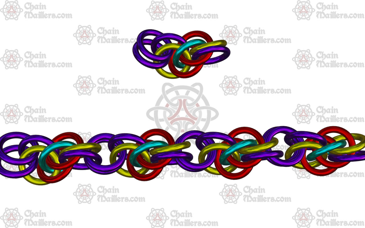

If this is a Dolphin segment and as per the description (and the original MAIL image) they are additionally connected (we currently call that "tethered" or "spaced", still working out the actual defining characteristics) then what is currently called Dolphin, would, based on CCT, actually be Dolphin Tethered or Dolphin Spaced.
I feel that actual Dolphin would be something like this, which is a direct translation of Dolphin cells.

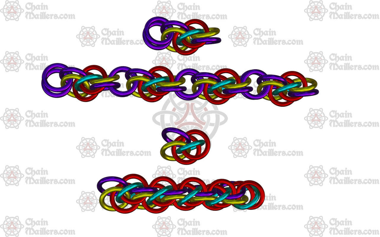

How does this all relate to your weave and why I suggested "Rover" related as opposed to "Dolphin" related? Its relation to Dolphin is what CCT currently defines as "symbiotic" or "sympathetic" (I forget which word I used, lol). The Dolphin cells are only created as a result of the connection of two base cells used in the weave. If you take away the rings that make up the "Dolphin" cell there are rings leftover. Technically, your weave would be senior on the hierarchy as segments of your weave would make Dolphin as it currently stands. The cells in the weave you're describing have 5 rings while Dolphin has 7. Rover on the other hand also has 5 rings per cell and the only difference between it and yours is the placement of a single connection (over opposed to under).
Dolphin vs Moaatt:
Question to ask yourself: forgetting the paired "spacing rings" in Dolphin as currently described, what rings are missing in the "Moaatt" version?
Moaatt vs Rover:
Question to ask yourself: what is the difference between "Moaatt" and "Rover"?
These are just a few of the things that I look at when evaluating weaves both old and new at this point in my examinations. Most of the weaves listed in the Maillepedia have either not been given these examinations or were given it in a cursory manner.
Hopefully my explanation is clearer than mud ;)
