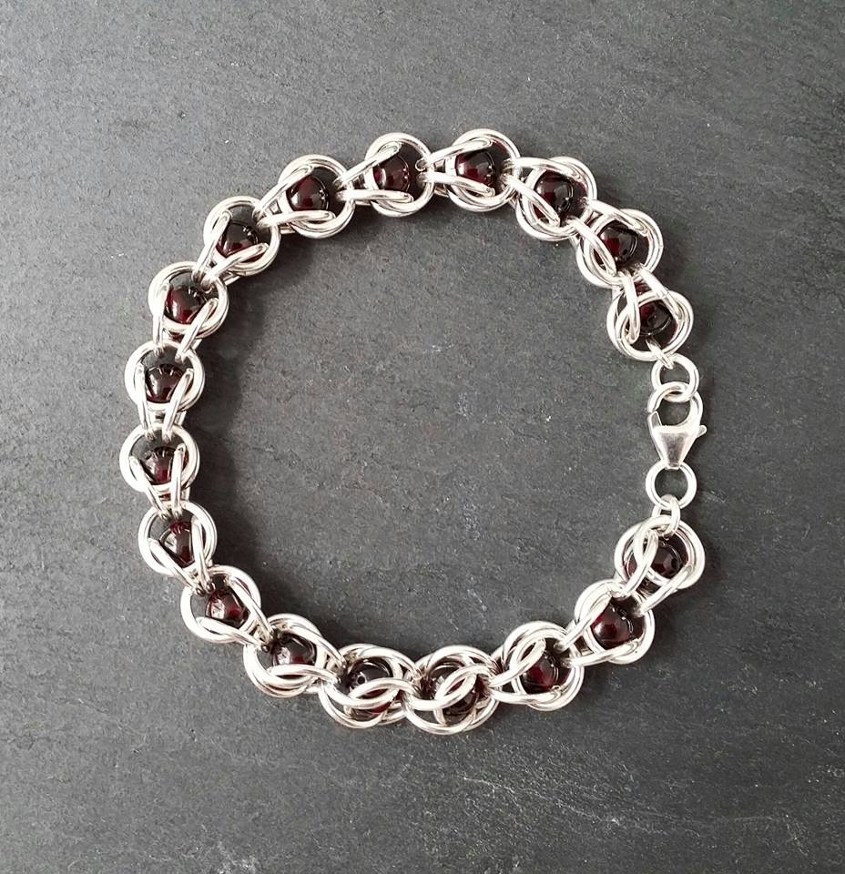

I used 6.8 id, 1.1 mm wire and it went smoothly. But the 6 mm garnets I used varied slightly in size so I picked the smaller ones. Was going to add a pic, but url... erm.
Arwen Jewell
A Arwen Jewell if you click the little picture icon (the one with the mountain in it) you can paste a URL in the box that pops up :)
So nice of you to reply :) My computer skills have some embarrassing gaps. I was going to post a pic that I had taken with my mobile that I have on my computer. I clicked on the picture icon and didn't know how to add a url for a photo on my laptop. Guess I could use the url from where I posted it on FB... Please don't judge me (smh).
